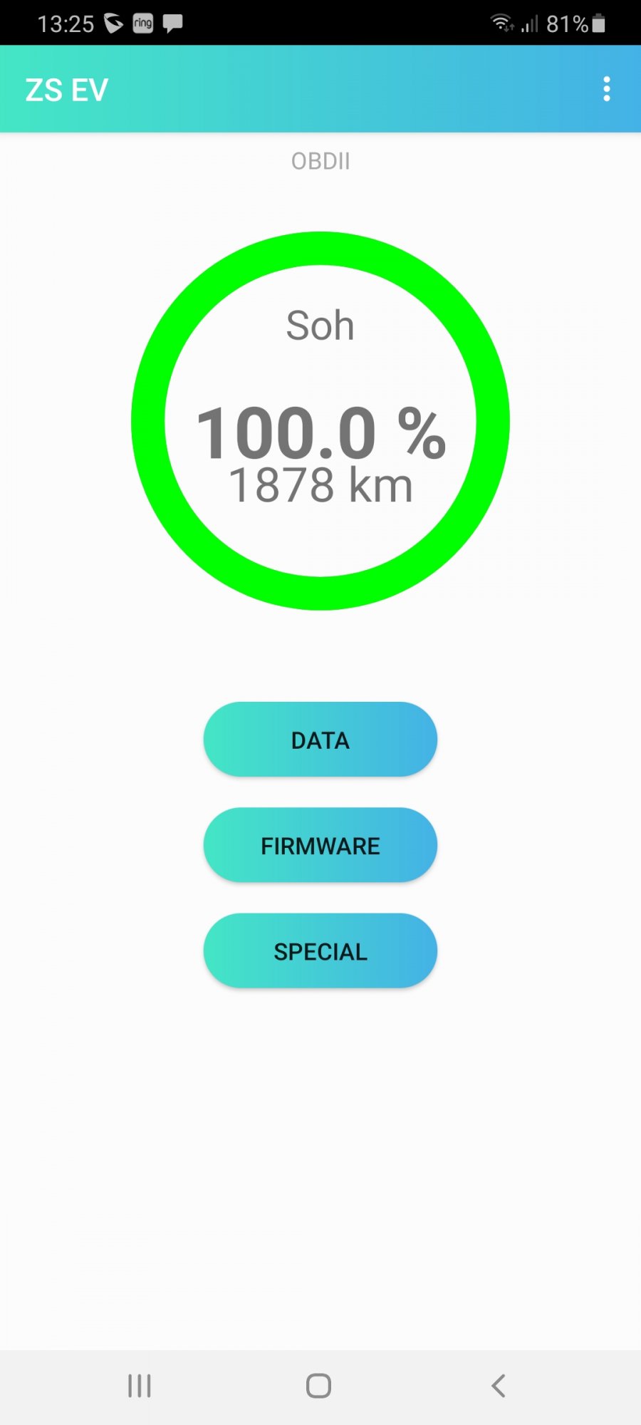

Been watching this thread for the last week or so, and was already planning to grab another OBD tool anyway, so... screenshot below, although I think it's pretty much similar to what others have already got. Comfort 2 done, as best as I can tell. Charging to 455+, and no issues with charging or range. Car registered in October 20, but only bought in January 21.

I was happy to see that the SOH of the battery in both cars was still at 100%, so it would seem theres been absolutely no battery degradation occuring, which I think is very good after a full years usage.

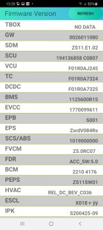

Just done mine. Picked up on the 3rd November. Believe CF2 was factory installed, BMS Oct one?. Cannot charge on AC with it unlocked, however charging stops and starts again if I unlock and then relock it

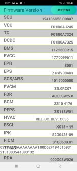

That's a bit odd.
You have BMS 1125600R15
Which I believe is the very original BMS
It's a bit odd if you can't charge AC unlocked too.
The EVCC 1770099611 you have matches what I thought was a very old one too.
I've never seen the DCDC F01R0A7325 that you have before either.
I've never seen the TC F01R0A7324 that you have before either.
Very odd!
Could it have been a car that was produced a long time ago and sitting in storage???

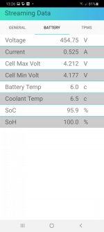

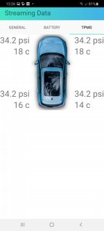

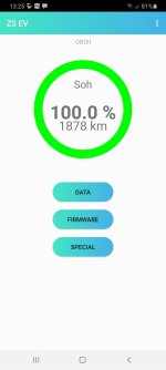

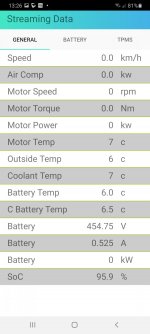

No need for torque pro unless you want a nicer layout. Pics below are all from personal testing. All I needed was a £10 Bluetooth OBD2 device (eBay link, others may work too ) .
Incidentally, the BMS on mine is R28 (??July update). If we can find out what the October and January updates were named would be useful.
View attachment 1729View attachment 1730View attachment 1731View attachment 1732
