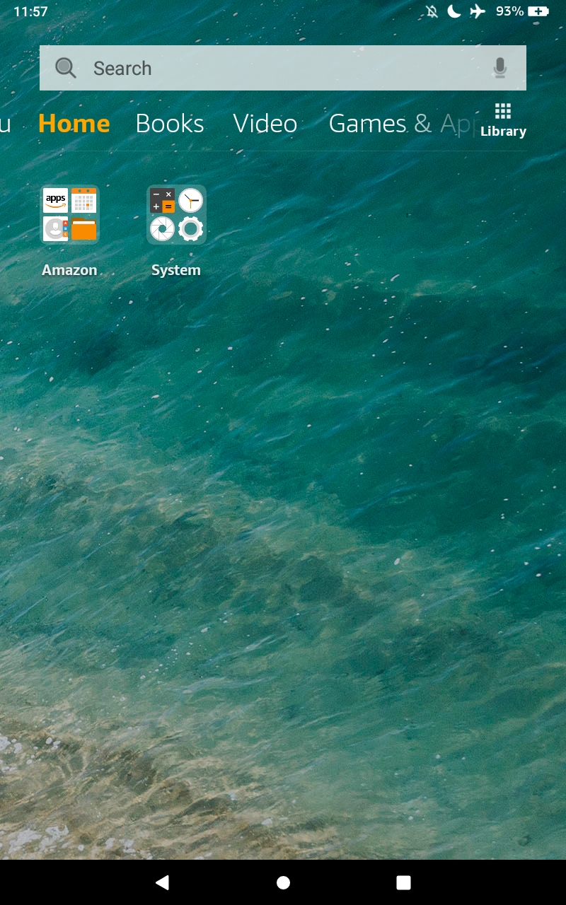

How did you get it installed on the Kindle Fire (or is the screenshot above for a different device). I can download and get the file on the fire but when I click on it I keep getting the same parsing error. I have enabled third party apps in the security settings.
I can't get it working on my fire 7 that's about a year or so old.
It works however on a more recently purchased fire 7.
They use different versions of Android under the amazon skin. Amazon will not let the latest version of their OS be installed on the previous fire 7.
(I actually bought the new one which is practically identical because of this reason - you can extend the file system onto an SD card on the latest one)
All versions of the app cause the "there was a problem while parsing the package" error on the older fire 7. On the new one it (ver1.3) installed fine.
(It does crash every so often)
FYI to install on the Fire 7, I had to do the following:
I installed the File Manager application by Rhythm Software.
In settings -> security -> Apps from Unknown Sources; for File Manager turned on Allow from this source.
I had problems getting the apk file onto the device.
In the silk browser I couldn't download or open the apk file from the google drive.
I ended up having to download it on my mac and put it into my dropbox, then via the silk browser logged into my dropbox and it then let me download the file.
In the File Manager app, I then went to the Download folder, and ran the apk file to install it.
Job done :)
