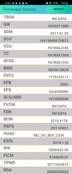

Been watching this thread for the last week or so, and was already planning to grab another OBD tool anyway, so... screenshot below, although I think it's pretty much similar to what others have already got. Comfort 2 done, as best as I can tell. Charging to 455+, and no issues with charging or range. Car registered in October 20, but only bought in January 21.
