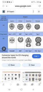

For AC you will never get higher than 7kW. (see picture for AC), irrespective of whether it's tethered or not.
For DC (see picture for DC) it can be higher. You will always have a tethered cable for this.
Note that's for UK MGs. Other cars from other brands may get 22kW from AC chargers. But not the current MGs sold in the UK.
Its nothing to do with the cable. It's what's in the machinery of the car that determines this.
