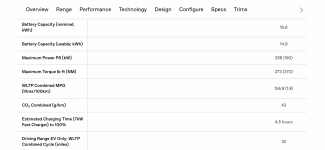

I have tried 3 times (on 2 separate chargers) to use public charging, however I am finding that the lock for the charging cable continues to make a locking sound. The charger then says that charging has started.
However charging will charge barely start, as the picture shows.

Yes it will only charge at the 3.3kw which is the onboard charger
The HS PHEV has a 14.9 kWh usable battery, time quoted to charge to 100% on a 7kWh charger is 4.5 hours. That only works out at 3.3kW per hour charging speed - which is confusing as I thought it would support 6.6kWh similar to MG EV ?‍♂️
