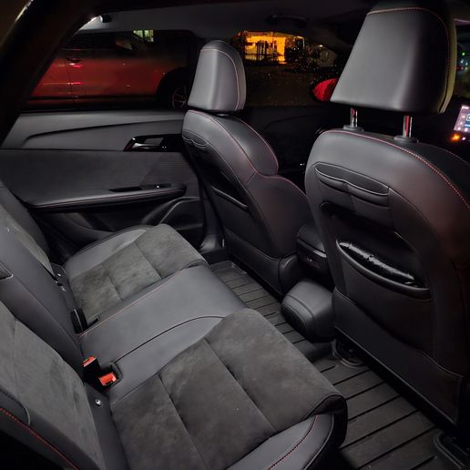

I designed a holder for the larger USB rechargeable touch light on AliExpress. Fits nicely behind the passenger grab handle. More details and the STL file here:
View attachment 24155View attachment 24156View attachment 24157View attachment 24158
Like that, impressive, nice and neat. Looks O.E. ??
Thanks, yep here you go, it's the 8 LED white version -
TIP: Ditch the magnetic plates & use adhesive velcro. It reduced the weight & worked. The plates & double sided tape resulted in finding it on the back seat or floor all the time. Hope this makes sense & helps ?‍♂️
How did you secure it please? Tried similar & they always fall off ?‍♂️
Go back a page and read the story :LOL: it did fall off but then I bought a special 3M tape that's super sticky (3M VHB 5952) and it's been working fine since I put it back up like a month ago
