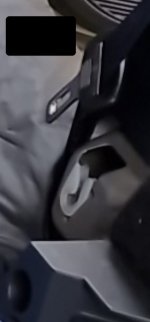

An alternative is to remove the back rests. If you are happy to keep them in the car you don't even need tools, otherwise you have to undo one torque bolt at the bottom of the middle seat belt.
I have removed the seat base ok. Just watch when you go to put the seats back upright that they latch into the lower hinges correctly if not they don't fold back quite right. Easy to do just have a go with it. On my SR I raised the boot floor by 90mm to get it almost level.

A nice neat and tidy photo at a useful angle, if only I'd taken one of those before I put the seats back in.
I don't know why manufacturers don't put the seat hinge higher up so though there would be a step there at least the back of the seats would be flat allowing boxes etc to be placed there without sliding down.
