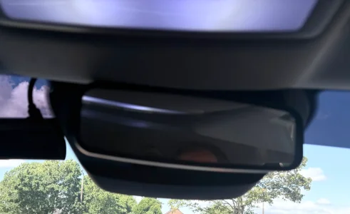

Hi
The shroud around the mirror is in two halves left and right
Just feel around the edges and you will feel the clips holding it to the windscreen
Just unclip those then unclip the two halves
The mirror is held on by one screw an then just unclip the wires
I did this in the first month
I’ve attached a rear view mirror from a Fiesta to the top of the shroud near the headlining
