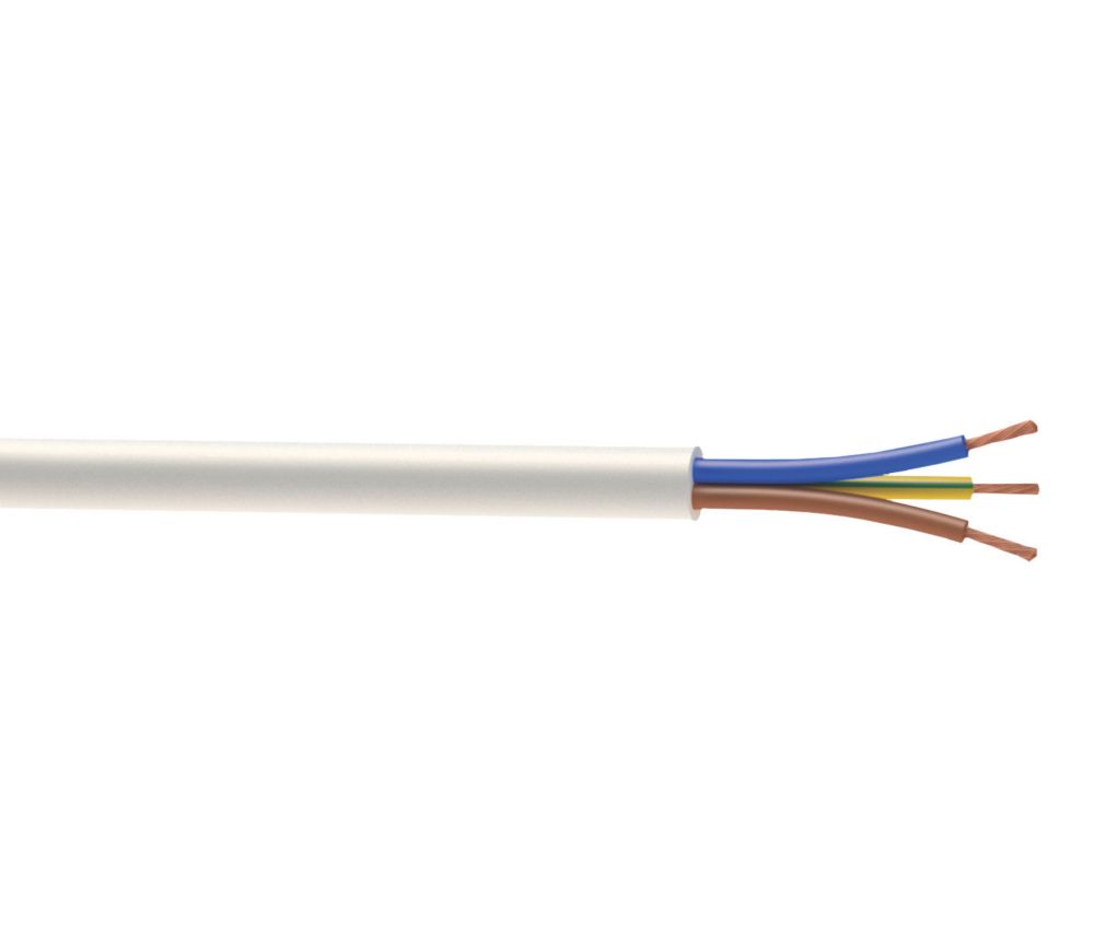

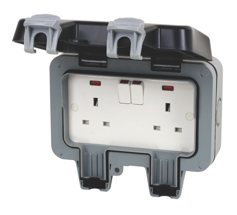

I made one up using 2.5mm cable and a masterplug weatherproof socket. The cable is a tight fit.

Look at Screwfix. They have a decent range of heavy duty outside extention leads with waterproof sockets you plug into. When using a granny and and extension (if away from home somewhere), I will place the plugged in bit under the car when charging, to reduce impact of rain even further.

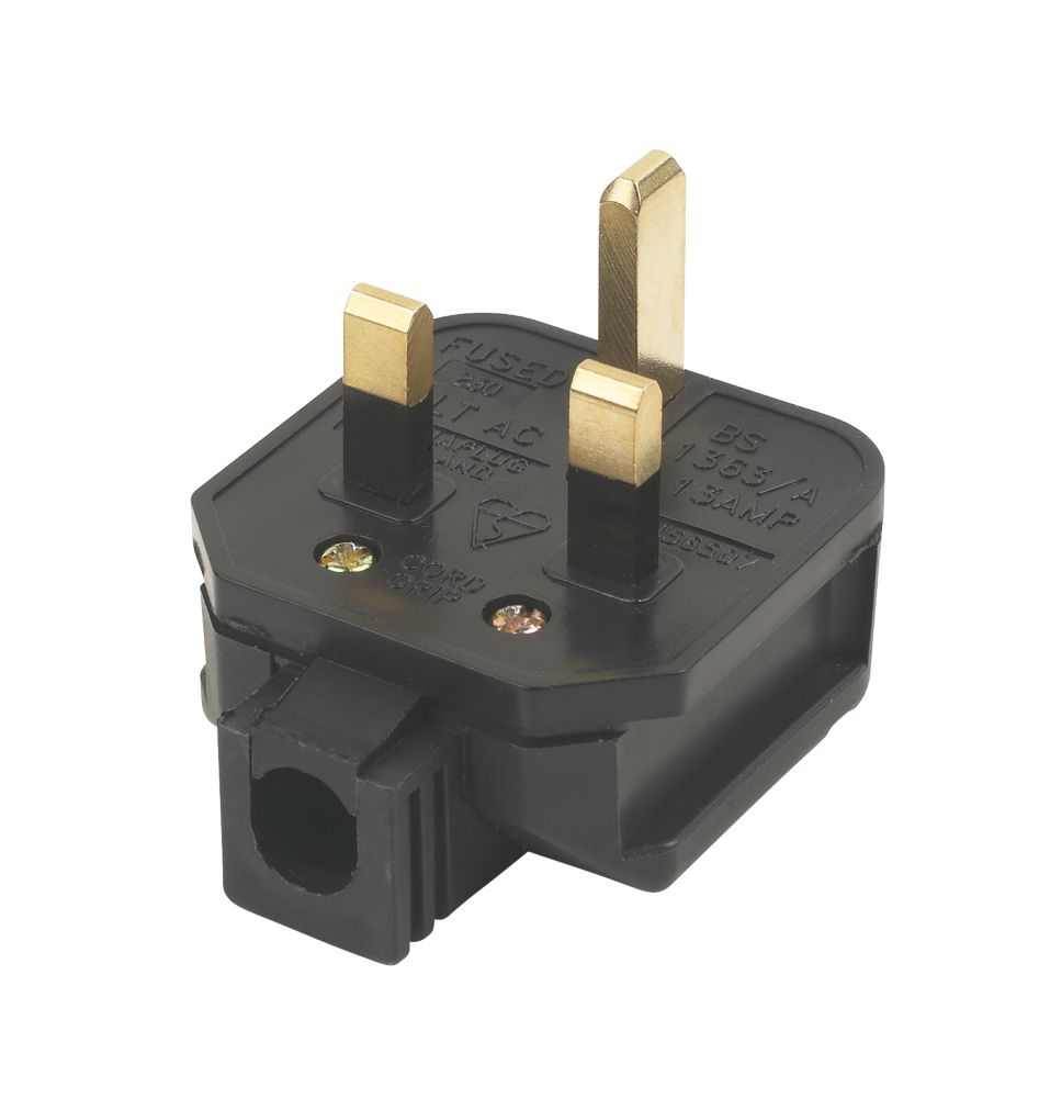

Same here !.
I made my own lead to use if we take a short break away and the public charging network availability is poor.
I already had the flex, so it was a cheap job.
Some links below, if you feel comfortable in making one yourself ?.
As you require a lead 12 - 15 metres long, then the best option is likely to be half roll of 25 metres.
A full drum is 50 metres in length.
Given the distance, I would not be tempted to drop the cross sectional size of the cable lower than 2.5mm for safety reasons.
If you decide to go down the route of making your own cable, here are some links below, that you may want to consider suitable for your requirements.
