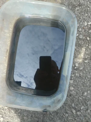

I did mine last week, I posted it on another thread, it was dirty and it had metal on the plug. Now my MG5 has a full service history and the 4th and 5th service were done elsewhere and last year! So looking at my oil it hasn't been done! I trust my current dealer but I own a garage so why would I pay for someone else doing the service on my car? Likewise I am going to rustproof the car as at 3 years old it needs it before it starts going rusty

What gear oil did you use and where is the drain plug located?
Also, is there a level plug? I assume there is
The filler plug is on the gearbox accessible from under the passenger wing and the drain is at the bottom, I have a ramp so didn't really take much notice. My only advice is make sure the filler plug undoes before draining!

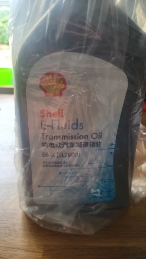

Hi Folks,
I need the help of the hive mind and maybe @MilesperkWh
I wish to keep my MG5 long term so was hoping to swap the reduction box gear oil now I have covered nearly 4K miles.
The manual states Shell SL2808 and nobody has heard of it...not even my local MG dealer. They said they don't even deal with Shell and would get Fuchs but they didn't seem to know what type so let's hope they find out before the first Taxi needs a change :)
So the question is what grade of oil is required I guess?
Cheers All
Just had mine done this morning. The MG Dealership used ShellSL2808. The bottle was covered In Chinese writing but underneath it clearly showed sl2808. (1litre). I checked with MG Uk ...they said they would only meet future warranty claims on the reduction gear if the oil was done at the 4th service.

My area MG Dealer used Shell SL2808. The engineer showed me the bottle, which had Chinese writing with "Shell SL2808" underneath. Should add, mailed MG UK to check when this was due as I couldn't see it on the service schedule. They said it was due at 40k miles or 6th service whichever came soonest. MG UK also told me this service item needs to be done to allow approval of any future warranty claim involving the reduction gear.
This is the stuff they use, I bought some from a Nissan dealer for £26 in the expectation of doing it myself, as my cars 4 years old, but MG are doing it at its service this month anyway.
