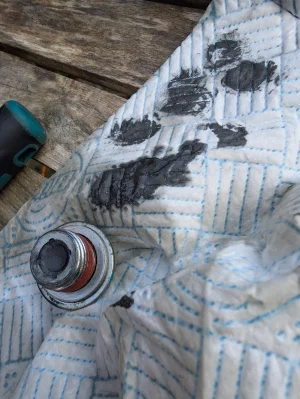

Top plug is a 17mm bolt and the bottom is an old style square head bolt. I used an adjustable spanner on the bottom bolt. Note that the drain bolt (bottom) has red thread locker on it.

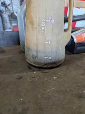

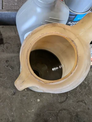

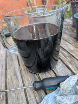

Drained out 0.7 litres, it was black with some silver sludge. Installed drain plug. New oil is smelly but clear. It's readily available in the UK on the brown and gammon website.

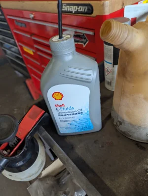

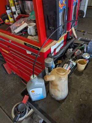

I used a screwdriver to poke a hole in the lid and l pushed in an old plastic tube. Then I poke a small hole in the neck and used compressed air to force the oil out the bottom and up the tube. See the photos :)
Put 0.9 litres in as it seems to be the most common amount that comes out. Also Autodata lists 0.9 as the correct amount.
