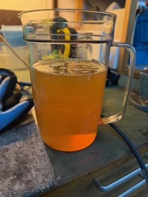

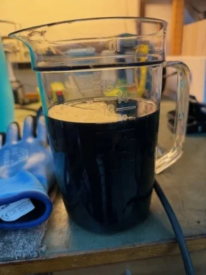

I haven't been able to find a comprehensive video or source of information to DIY the job, so I thought I'd drop my findings so far in this forum post. It doesn't look to be too difficult, so I'll do mine at some point over the next 12 months.
The relevant oil is 0.9 litres of Shell SL2808, otherwise known as E6 iX.
The images below are provided from various other posts on the internet, but give an indication of where the filler/drain bolts are and the relevant torque settings for the plugs.
I hope this helps somebody. If you have more info, or a video, please tack it on below.
