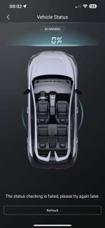

It’s most unusual. My iSMART wouldn’t work all morning. Was fine when I got to work. Completely dead again when I tried to pre heat the car after my shift and still dead when I got home. I had a few spurious air bag warning messages whilst in work so I’m curious if I don’t in fact have any airbag fault as such just every time the car decides to finally connect up to the network again it’s throwing that up ??‍♂️
Update: still wouldn’t work this morning. Deleted and reinstalled app and it’s sprung into life… I won’t hold my breath though.
Deleted and re-downloaded the app this morning and it sprang into life…. Hurrah…. Nope Spoke too soon ?

I logged off of the app on my phone, logged on with a different phone, but still get the same message when I try to unlock the car or turn on air con. Strange that all the other functions work. I can check the vehicle status, find my car, see the battery status etc. Is there anything else I could try?
I have deleted and reinstalled the app and have reset the head unit, and still iSmart does not work at home. I then drove 1km to where there is a good signal on all UK networks and iSmart worked fine. EE is the only network that I can confirm gives me a good reliable signal at home, and so I have to assume the eSIM does not use the EE network. I have contacted the dealer I got the car from to see if more info can be provided.
