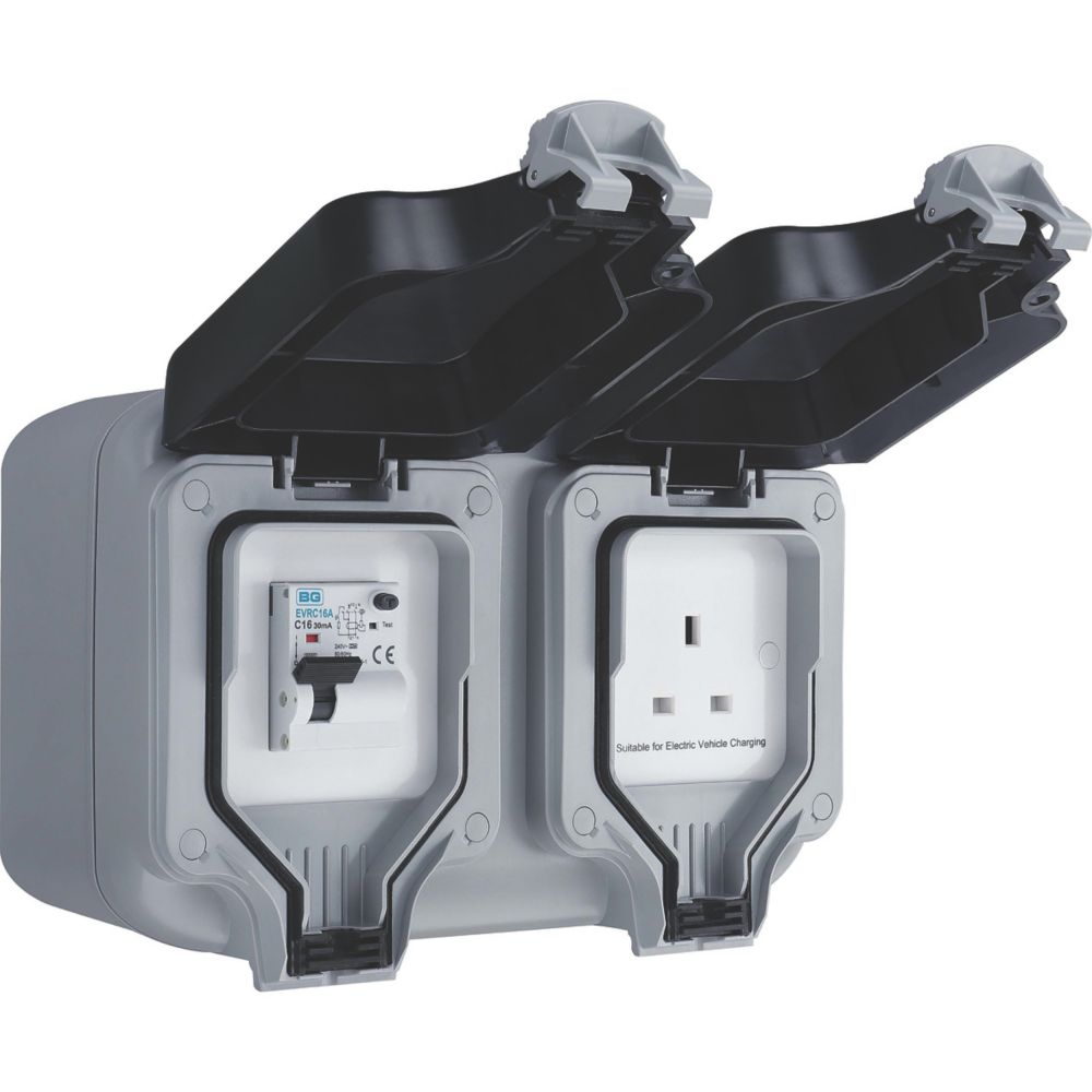

I fitted one of these.
I don't use one of those (as I have a hypervolt 2) but the property I stayed in over Christmas let me plug a granny charger into one very similar to that. I ran it over Christmas Eve evening to Christmas Day morning and again over Chritmas Day evening to Boxing Day morning. That was sufficient to charge it up from 20 % to 100% ( LRTC). Worked fine with no heating damage to the charger cable plug.
