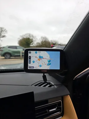

In my previous Merc, which had a decent sat nav, I used my TomTom and I’ve continued using it in the MG HS. One advantage is that it can easily be moved to a new car while keeping all my favourites and preferences.
I’ve set up a smart routine on my phone that automatically activates the hotspot when it connects to the car’s Bluetooth. This allows me to receive live traffic updates and alerts for reported mobile speed camera vans. Updating the maps is also simple, I just connect it to the home Wi-Fi.
I know some people prefer to use their phone for navigation, but I don’t like having to plug it in and keep it charged on longer journeys.
