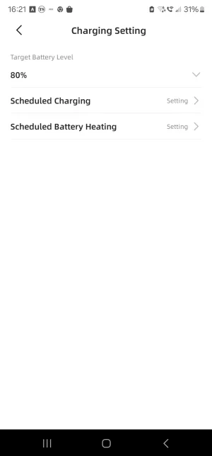

I've got the SE SR anyway. Didn't realise you couldn't restrict the charge. In my MG ismart app I can set the target battery level to 80%. Is this different to restricting the charge in the car?

I thought the SR with its LFP battery did not have the function to limit the battery charge level.
It doesn't ... there is no slider in my car or in my iSmart app for my SE SR. The forum update means that all we know is that @Jonperry64 has an MG4, but not which variant* - if he has the SE LR then he will indeed have the slider.

I did add the variant but it's been removed for some reason. Mine is an SE SR 2025 model. Maybe only the newer models have the target battery level?

Can you? That feature disappeared from my app within a few weeks of getting the car. MG don't seem to want people restricting the charge on the SR, although of course you can do that yourself by limiting the charging time.
I have no way to restrict the charge on the app, although the infotainment screen still displays the irrelevant legacy "health mode" still, as it does for the NMC batteries.
(ETA: I tried looking for an update in the app in case they'd decided to put it back in, but Google Play Store seems to think I have the latest version.)
