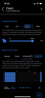

It ramps up over a few minutes. Did you give it much time? Mine is set like this and charges at about 6.5/7.

So, 10,000 MG4 miles done with Zappi. My method...
  1. Don't set a schedule in the car!
  2. Set a timed boost in the zappi app/main unit for your cheap rate. I just set from 1am - 8am
  3. Make sure your zappi mode is set to ECO+, note after a firmware update it will default back to FAST
  4. In the car/app set the charge to 80%. Note, if you have to reset the infotainment screen, charge rate will default back to 100%.
Also creating a Zappi timed boost window as long as possible (inside cheap rate) allows the battery to balance if you select 100% charge.
last one... if you have a power cut the Zappi will reboot into FAST mode and start charging as soon as power comes back on. So if you have a power outage before your cheap rate, you'll need to put the mode back to ECO+ to stop the charge
