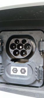

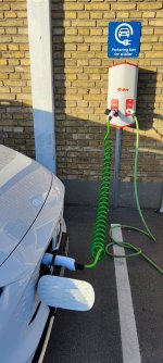

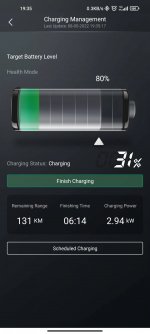

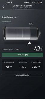

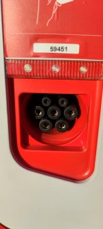

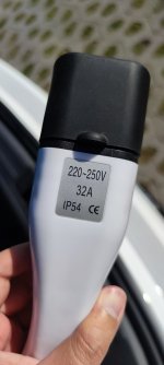

My ZS long range doesn't seem to slow charge faster than 3 kW, I was expecting to get around 10kW (this is Danish car version, not UK) .
Attached some pictures with the cable and charger.
Do I need another cable?
What is the speed that you guys are charging with?

2 questions is it definitely a 3 Phase charger as only see 2 outputs?
Is the cable definitely a 3 Phase cable?
Sounds like the car may only be getting 1 phase

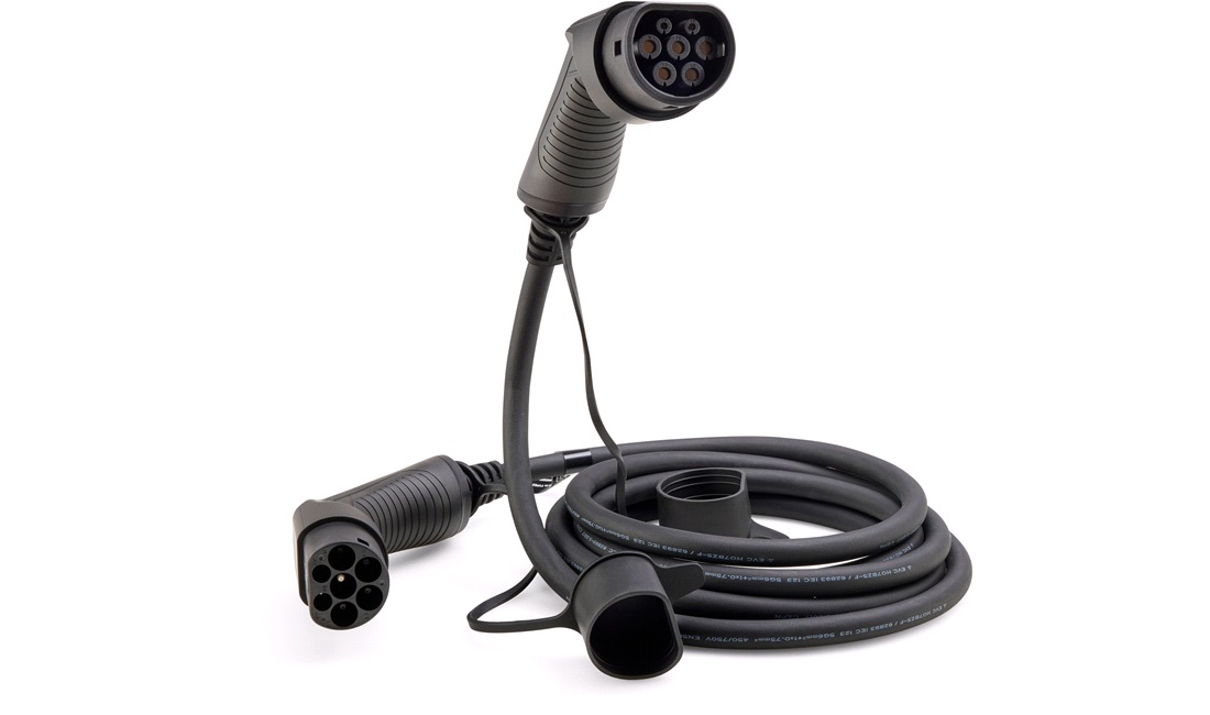

Cable looks to be this one from Thansen
If so, it's only 1 phase.
1 phase means max 3,6 kW.
For 11 kW you need a 3 phase cable (3*3,6 = 10,8 kW)
The cable supports 32A = 7,2 kW, but the ZS only supports 3,6 kW on each phase, and the charger is a 11 KW 3 phase charger in the car.

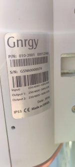

I just managed to get more pictures.
Right now I'm trying another charger, but is the same.

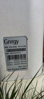

The charger has 2 outputs on the label because 2 cars can charge from it.

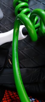

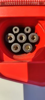

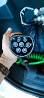

The only thing I can spot on pics is that compared to other lead is yours looks thin? Suggesting the cable is only 1 phase but the plugs look OK for 3 phase so the cable it's self could be the limiting Factor here
Good eye
I didn't notice that, but you are right, is thinner.
Good eye
So it's either a fake 32amp 3 phase or miss labelled 32amp 1 phase
It's can't be a 16 amp 3 phase as you would still get 11kw
That's my own theory and I could be wrong but gives you something to look at
Just for reference my 3 phase is about 19mm ish and my 1 phase is 14mm ish
measurements are going to vary brand to brand
@Enucos quick question is that wall box a 11kw? Edit sorry my bad just remembered it says 32a so 22kw that sucks if your cable is 32a single phase as if u visit the UK you will be limited to 3kw
The charger is 22kw, and yhea, I'm limited to only 3kw

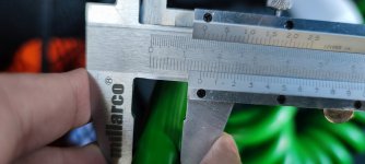

I will measure the cable thickness tommorow
Your absolutely right
3 phase says 5x6mm1x0.5mm
1 phase says 3x6mmx1x0.5mm
There my 32amp cables

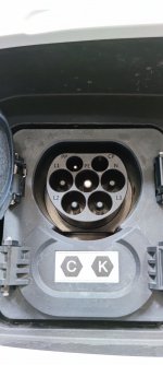

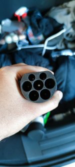

In picture IMG_20220508_141951.jpg I can see what looks like the end of the cable. It says L1, L2 & L3 for the 3 phases but I can't see if there are pins in these holes. If there are pins in L2 and L3 you can see if they are connected to the L2 & L3 at the other end of the cable if you have a multimeter that measures resistance or conductivity (ohms). Only do this when it's unplugged of course.
The thing is the 1st part of the pins have a non conductive coating in black so don't show up very well I am sure I can see them when I zoom in L1 and L2 easier than L3 but all seam there
I did not manage to measure with a multimeter, but I took more pictures with the cable, I'm not sure how to read that and what it means : 3G6.0mm+2x0.5mm 450/750V
Is only 15 mm, so probably is not a 3 phase.
