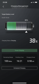

Hi, it looks ok to me if the photo's show how much you have charged rather than the rate? At 7kW after 8.4 mins you will have added 0.98kWh (or 8.7 mins at 6.8kW)
No that is the rate. Off my Hypervolt I was getting less than 1 kW. It’s sorted now though, user error. Buried in the Hypervolt settings in the dark places I tend not to go, it was set to solar only. Not much good when I don’t have solar panels. (Apparently solar only trickle charges off the mains to maintain battery health) Changed the settings and it’s all good. It’s actually plugged in now and charging at 6.47 kW. Thanks all though. Like I said I’m new to all this EV lark and learning as I go.
