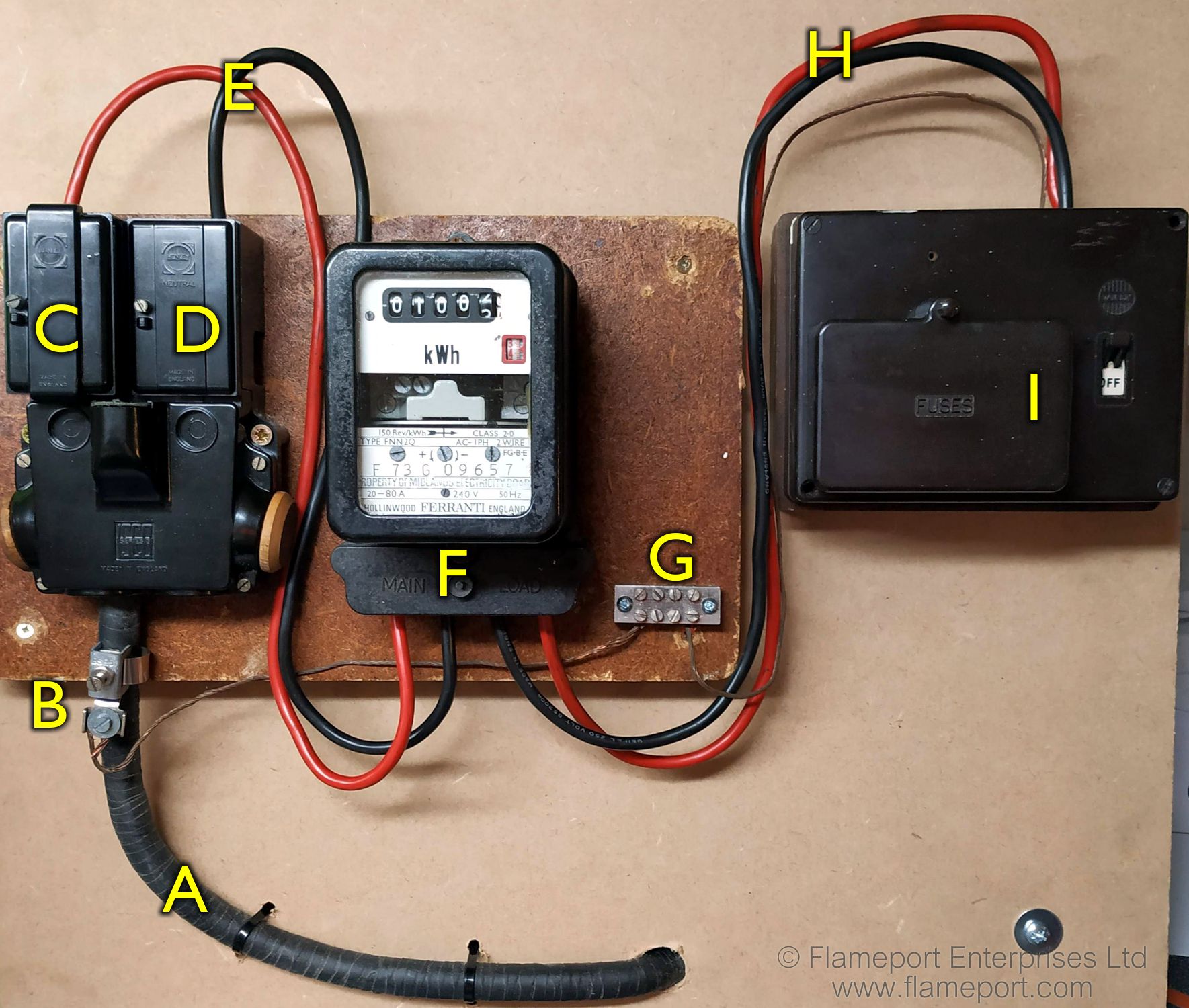

What form of Earth does your house have? Does it say PME on the head?
The picture above is a typical PME with the Earth being provided from one of the concentric conductors of the supply. Do you know the size of the main fuse fitted (not the capacity of the service head) at C and do you have a main isolator around H on the picture?
There's an earth cable going into the main black box. It says 80a on it too so assuming it is 80 amps supply to house. Pic below of my supply
I hope that is genuinely the fuse fitted, it may just be the maximum rating of the unit. The danger is that depending on your other loads you may need load limiting.
In terms of Earthing it's not possible to see from that picture but what you describe sounds as if you will need Open PEN protection as well as an additional RCD and circuit breaker.
