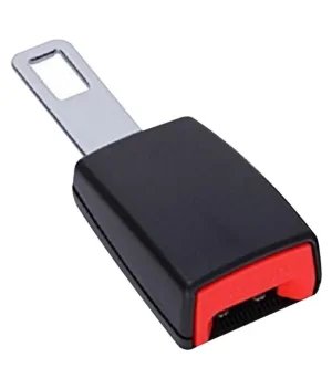

Due to my big belly I have no problem moving the car with the seatbelt unbuckled. ;)
I bought one for the MG. I don't drive with it, because I don't need it. But I do use it if I need to just move the car a few times - having to mess about with the belt becomes a nuisance. Every other car I've driven just has an alert, the MG is the only car I've had that prevents you driving. What surprises me is the variance between similar cars. You'd imagine that they'd all be the same with things like this.
