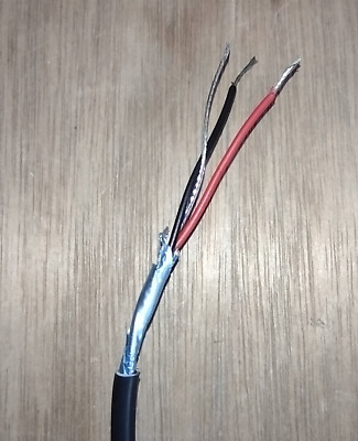

My setup will require a cable run from the consumer unit to the garage, where the setup will reside, a run of about 10 metres. I assume that the CT cable can be hooked near the inverter end and not at the meter tails. Otherwise, it will need an other long cable run.

No problem, i couldnt believe the price of the Victron unit and actually sent it back having seen it and measured burden resistor etc. It is just an industry standard SCT 013.
The CT does need to be on the meter tails to measure import / export, I extended the cable on mine using screened twisted pair cable:-
Straight forward to do, I took the CT apart, it just clips together, and soldered the cable in directly. Victron say no more than 5 metres for twisted pair, thats why I used screened twisted pair and mine is a run of 25 metres! It's absolutely fine, I used a scope on signal and it's no problem with the cable length.

Soldering I can do, as I have the tools for it. I have also a bit of sticky aluminium foil to bridge the two cables.
Excellent, just connect the screen across the joint, should be easy, heatshrink sleeve over it to make a proper job.
