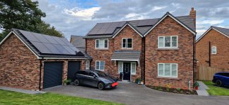

So this is my current setup, 10 panels on garage roof and 9 on front of house.
I'm asking for a quote for another 22 on the North facing back of the house and another 10 on the back of the garage.
Problem with back of garage roof is its west facing and restricted by trees, back of house obviously North facing but no restrictions.
Is it worth it do you think, legal / technical limitations. I have a 5kw inverter, does that mean the max I can generate is 5kw at any one moment or will the rest just go straight I to the grid as it would end up being a 51 panel 405 kw setup so would end up being a small PowerPoint on my house. Octopus Flux gives you 28kw at peak so if I got another 10kw battery I could maybe generate quite a bit of income a year.
Thanks
I am NOT an electrician but my understanding is the answers to your questions are Yes, and No, in that order.
The reason is that all Solar PV panels generate DC electricity and the job of the inverter is to convert that DC to AC, which is what is then fed into the grid. I suspect you will not be able to increase the output of your panels without an equivalent increase in the output of your inverter.
