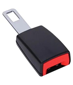

Well one of these days, that may not work, you'll just have to put belt on before it will go into ready.
How to overcome seat belt warnings and associated problems. ;)
