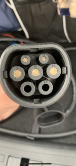

Is that what this is? In that case, I was misinformed as to the name, cheers.

The CCS includes the two other pins under the second rubber bung for DC rapid current.
If it was 3 phase then the L2 and L3 pins on the type2 would be populated.

In the top photo is what the pins look like in the common Type 2 lead that you already have.
In the bottom photo is the much larger and heavier CCS rapid charger pin arrangement, you can clearly see the two additional larger pins under the normal type 2 pin arrangement.
These two heavy pins are utilised when when using the D/C rapid charging units.
Simply, the larger pins allow faster charge times.

I should've said - the pic I posted was the cable I was supplied with. If I use the cable from the charging site, I can get the CCS charging
