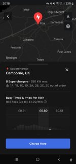

I have a 2024 MG5 Trophy wouldn't link to a supercharger. The app showed them all out of order as per the screenshot but there were two Teslas charging. How would I know if my vehicle has had the update?
There really isn't any way to tell other than trying it at a charger that the app says is available. (I think that Tesla sometimes reserve specific chargers by marking them as out of service in the app for non tesla owners)

Thanks Kevin. I will give them another try when I get home after the Christmas holiday
