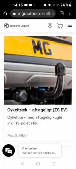

You can fit a 'tow bar" but only for carrying a bike rack. We have that installed to bring our daughters bike to school in winter time. I am tempted to try to pull a small trailer, but I am afraid because of problem with insurance if something's happens😬

The fact that you 'can' fit a tow bar doesn’t mean that you’re permitted to. The EC Directive is quite clear - if a mechanical coupling device, i.e. a tow bar, is fitted to a vehicle then both the coupling device and the vehicle must be type approved for that purpose. For whatever reason the ZS EV is not type approved to have a coupling device fitted so by definition there can’t be a coupling device type approved to fit it.
Having said that, if you fitted, for example, a tow bar with a flange tow ball fitting and discarded the tow ball and then bolted a cycle carrier to the flange, you could perhaps argue that you no longer had a coupling device. However, a quick look at the fitting instructions would seem to suggest that to fit the bracket to the ZS EV you have to replace the bumper beam with a steel cross bar and that sort of modification would surely need to be notified to your insurance company who would probably take a dim view of a towing bracket being fitted to a vehicle not type approved for towing.

If you click on the picture. You can see who has sold it to me and fitted it.

I would suggest that you ask them for a copy of the type approval certificate for the tow bar to verify that it is approved for use on a ZS EV and not just a ZS

That is an optional accessory on the official Danish MG ZS EV ordering site. I hardly think that they would be offering illegal accessories on the ordering form for the car.

It will be MG's own fault to deal with if that was the case. I bought the car from an official MG dealer, the bike/tow bar is from MG's own accessory list for a MG ZS EV and they have sold me the insurance called MG( In partnership with another insurance company) so I feel pretty confident, I know the towbar is difficult to install, they have to take things apart from the inside of the boot. When taking the inside apart the panels got cracked because the part is sitting so well together. But that was fixed without any cost to me, had to wait a month for a new inside panel to be installed. But everything turned out fine 😀

As I said, I would ask them for a copy of the type approval for the tow bar as no such thing exists. They will just have fitted a ZS towbar which is illegal. Does it also have the trailer cable harness?

It is only for carrying bikes. I can't remember the total load that it can carry. But it is around 40 kg.
No cable harness attached.

Just to make it perfectly clear. It is sold ONLY for carrying bikes on a bike rack. In the installation of the (tow)bar they also made the electrical wiring (13pin) for the required lightbar with extra license plate that we have to use in Denmark.
In Denmark we only have the ZS EV, not the regular ZS.
I just checked the official MG webpage for Noway and Germany. It's also available there. Maybe UK has decided differently!
Very interesting. As it’s a European Directive (dating from 1994) it should be implemented in a similar way across all member states which is why it would be very interesting to know what the type approval certificate of the tow bar says. But a quick look at the European site produces this. Methinks a note to MG UK would be in order.
