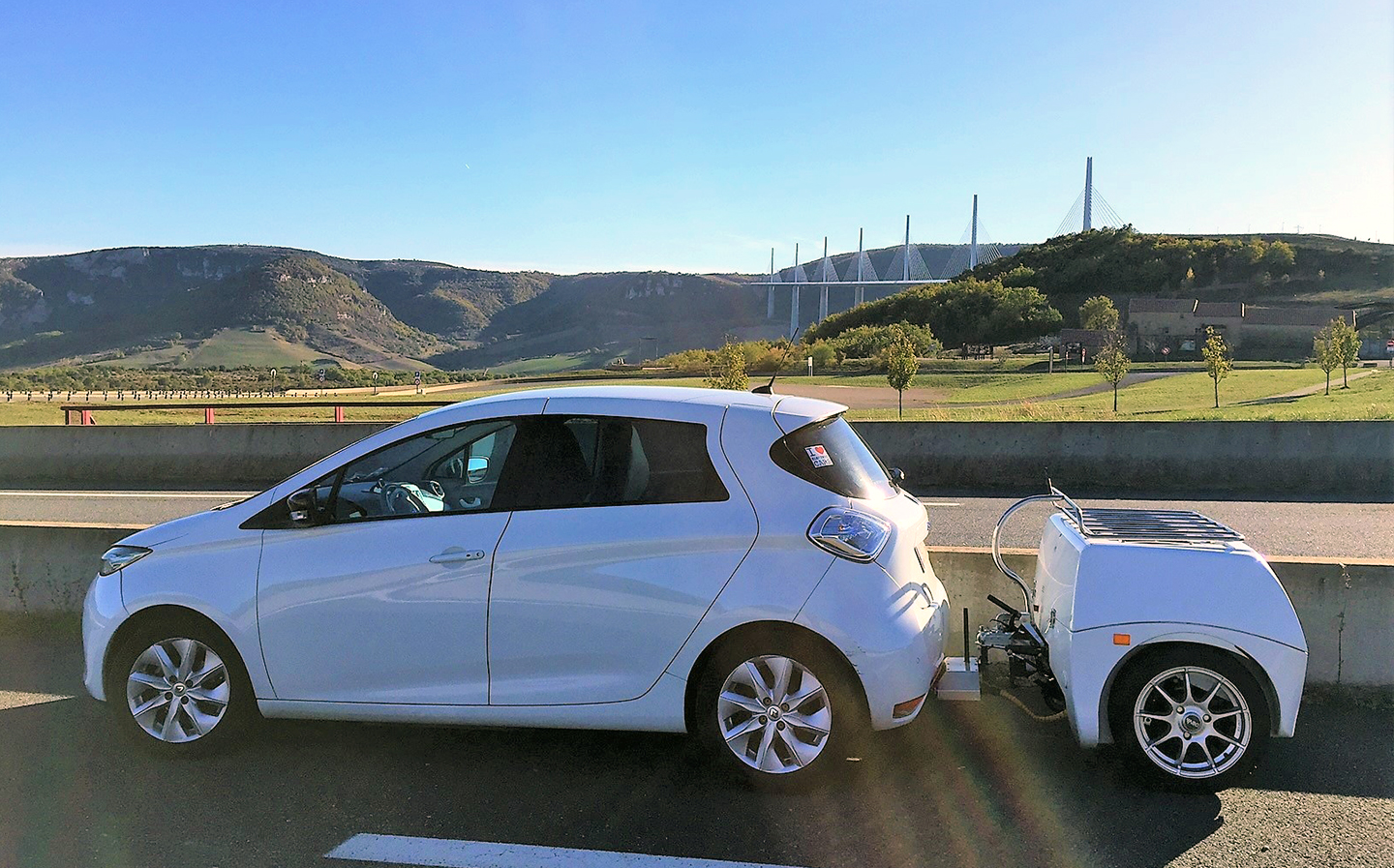

So I can't get one of these then....:LOL:

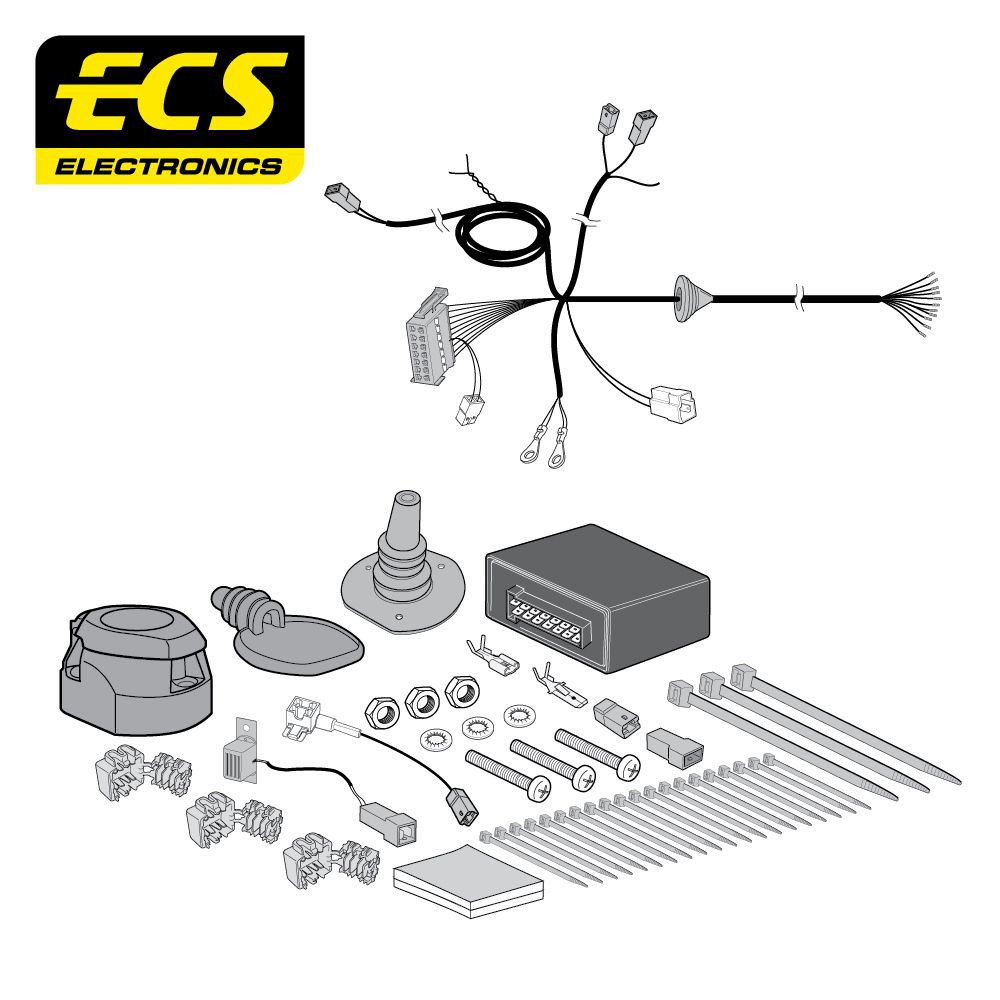

I have purchased the Brink tow bar for the ZS EV, type approved, E11 55R0111770, 4kN D-value so should have 450-500Kg towing capacity. I am just waiting the CANBUS module and electrical components and will prepare a mounting tutorial with pictures.
This could be good news.... Can you post a link to the CANBUS module and electrical components you have ordered too. Thanks
@Mychski I'm interested in a towbar for bikes only and whilst googling for a UK supplier I found the wiring kit you were asking about here if it helps. Still struggling to find the Brink towbar itself...
