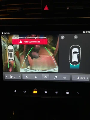

Have a 2023 MG ZS EV with Towbar recently attached. Noticed that on reversing with trailer connected ( or just the flap lifted ) that i get a error on the screen showing Radar Failure. The trailer socket appears to be wired with a reed switch, so i assume this is "working". What is the expected behaviour. Should that error always be displayed when towing?
anyone else have this issue, or can you tell me how your car behaves when the flap has a trailer connected ( or the flap is open ).

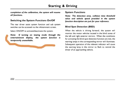

There is a "towing mode" on vihecle settings for "rear driver assistance system" to disable reverse sensors

Provided by mg. So yes mg approved. We have 7 pins plus two pins for reed switch which when reversing with trailer connected generates this warning . Do uk / aus have official tie bar kits with wiring and has anyone installed ?
