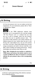

The metal valve stem has no parts that require coding, only if you replace the TPMS sensor itself, it may need its position on the car reprogramming.
Not sure on the MG5 but on the original ZS EV the tyre ? positions were coded into the TPMS in the car.
E.G. - If you performed a front to back wheel rotation, then the car did not have the ability to relearn the wheels new location.
So, the TPMS read out ( front to rear ) was incorrect really.
To correct this, it would require the wheel positions recoding to the car.
However, the facelift model of the ZS EV does have a relearn facility built in.
So if a wheel rotation is performed, the car will relearn the new wheel location.
It appears from @simorgan42 post above,
that the face lift model of the MG5 has the relearn capability, not sure on the original MG though.
It maybe like the original ZS EV that requires the car to be told of a change of location.
As the OP is intending to use the original sensor in the same location that it came from, then as long as the sensor is working correctly, it should not be a problem anyway.

Maybe it didn't meet the conditions at the end of the post #9.
