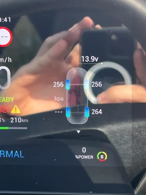

Had the MG4 Trophy L/R for 3 months now, love it 90% of the time, perhaps a common statement ? 10% that I don't are the usual software glitches/quality of interior plastics etc. I understand and can overcome these shortcomings most of the time. Recently though I have had a " tyre pressure monitoring system failure..consult manual" dash warning. If I stop , restart and carry on the warning disappears for a while then returns, sometimes followed by a warning of low pressure in either the left or right rear tyres. Following advice I read on here I've let air out, re-inflated in the hope that it may be a "stuck" sensor. This hasn't worked. The car is a 31/12/22 so still under warranty. Firstly, has anyone else had this issue? Second, do you think this is covered under warranty ( before I call the local dealer) . Always best to hear others views first I feel before I totally trust the local dealer (!). Appreciate any input....KR

Thanks for the swift reply. Just checked and they are ( cold) 2.5 bar which is 36.2 psi. Worth a try at 2.6 I guess( 38 psi) as you suggest. I would understand that if it was a low pressure warning message but it's a pressure system failure message i'm getting so I can't really trust anything it says if it's faulty. I have checked and the pressures are actually as shown on the app/car so it appears to be working ok. Local dealer visit I feel..
Actually, I have the same error in my car (in my case, I get a warning that the entire system has failed). I’ve got a service appointment scheduled for next week — they will replace the sensor. What’s weird is that in my case, the error only appears after driving at autobahn speeds (around 120–130 km/h) for about 10–12 minutes, and it only affects the left rear tyre. I think it’s either the sensor in the wheel or — what I could also imagine — that the TPMS uses a four-antenna design (with one antenna in each wheel well). Maybe it’s just a misplaced antenna. Unfortunately I was not able to find any information regarding the tmps anywhere online so it's just a guess.
