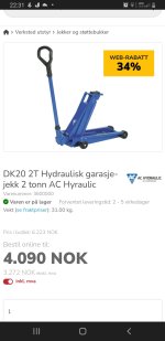

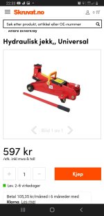

No and I realy do not recomend using a scissor jack, they are realy not heavy duty enough and far to unstable for use on an EV.
I juse a hydraulic garage jack I have 2, one cheap that just manage to do the job and a more expensive one that does the lifting safe and easy.
Cheap one is about 497nok or 45£ (I'm sure it's cheaper elswhere) the heavy duty one cost between 4100-6200nok or 360-544£ in Norway and is Danish workshop quality.
This is my second AC jack as I do not get my hands on the old one any more (30 years old now, time flys) when I need it as my brother (which owns 50% of it) uses the old one all the time. So I bought my self an updated an lower version as a gift to myself (and this one is not leaving my garage). 😄
I recomend AC hydraulic jacks or jacks of simelar quality for those who need a god sturdy jack and or uses it often. For more normal people a cheap 2 or 21/2t hydraulic jack wil do the trick a few times a year, but to be honnest I recomend to spend a little more money on a more stable jack than the one I'm show as cheap here (if you go for the cheapest jack, just make dam sure the jack and the car is on firm and flat ground and a wheel chocks are used).
