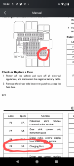

HI, there is yet another thread with this issue its called MG4 Charging lights not working started by WXman and I have copied this below from that thread.
Might be worth checking out
Les
WXman
Standard Member​
JoinedJan 1, 2023Messages17Reaction score21Points6 FarnhamDrivingMG4
From the owner's manual, it's the F9 5amp fuse in the driver side fuse box. It was a little daunting accessing the fuses via the side panel of the dash with the driver's door open. When I got to the fuse, it was very firmly in position - took quite a pull with long-nose pliers to remove it. As I didn't have a replacement to hand, I put the same fuse back in, and the charge port lights have worked ever since! I've attached the owner manual page, I think the fuse board map was orientated differently from memory - you might need to rotate the image - you'll see what I mean when you get in there!
Hope that helps and fixes this glitch for you, Good luck!
Les
WXman
Standard Member​

Thanks I mentioned this to the service dept, it turned out an update to the VMS solved the problem.
