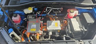

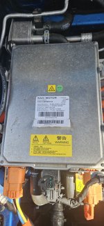

But I still think my car needs to get the 11473414 swapped out to the 11505199 in order for it to work. What module version have you got in your car?
I don't know, I can have a look now if you know where to look for it?
EDIT: Looking at the labels others posted, I think I found it - mine is 11254241
my one is 11473414

Huh. Does that mean that some people have had their on-board charger updated the expensive way (by replacing the entire EVCC / on-board charger)?
Or am I misunderstanding the numbers? [ Edit: I was! Sigh.]
Or maybe only certain third party V2L adapters, and not the official MG ones, work with the 11473414 on-board charger?

I just paid the £20 adaptor to try on my car, but I think my 11473414 does not work with any V2L cables or any adaptors, but worth trying 1 more instead of waiting 6 months for a no answer from dealer to swap out. I think somewhere mentioned chip shortage as some version of the module does not have the control chip for discharging?
@fred12345 You've got a different version number for the EVCC module to mine so I guess your car depends on the software update + resistor ohm value rather than the hardware like mine had.
I'm new to all this and looking at the different labels posted here, they all say Charge: blah, blah and Discharge: blah, blah - meaning that whatever version number we have, it's meant to Discharge too ...
You'd think that, certainly. But it seems that there is more to it, perhaps there is some sort of firmware incompatibility, who knows.
It may just be that the label on the 11473414 EVCCs is misleading (hopefully unintentionally) when it gives an AC discharge rating. The DC rating for the charger input, being the same as the AC voltage rating, also makes little sense. It may be a translation problem, though that seems unlikely.
My 2023 MGZSEV has the same issue. MG have confirmed that the issue is with the module. The reason being a chip shortage which did not enable this V2L function. SAIC are sending a replacement the module. They have not issued a recall or even told their dealers
Hi. Did you get written confirmation from MG about the component problem that you can share? I have the 11473414, which seems to be the problem unit from reading some of the comments further up the thread. Does anyone know what unit number it needs to be switched out to? Or will all others work? Is an update also required at the same time so that it works with doors locked?
I'm keen to get mine sorted ASAP. I'm already on my first camping trip and missing having the V2L.
All I can tell you is that when I contacted an ebay seller about purchasing a V2L adaptor he told not to purchase one as my vehicle (2023 model) was faulty. I then asked my local MG Dealer to check this and they then ordered a replacement module from SAIC and told me that due to a chip shortage this model year was shipped with this function not enabled and SAIC agreed to send a replacement unit of which I am still waiting for.
EVCC 11349836 ordered under warranty for my 2023 model. Installation tomorrow 9th May 2024. Hope that helps. Dave
