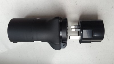

I would suggest 90% of the cost is in the EV cable itself, rather than the adaptor end of it. The only difference between a charging cable and a discharging cable is the value of the internal resistor at the EV connector end and perhaps a 3-pin socket on the other.
EV cable is eye-wateringly expensive, hence why I have bought one of the "cheap" Aliexpress adaptors and modified it. I have no intention of using it in the rain, but if I have to I'll find a way to keep the rain off.

The "EVCables" adaptor unit does not appear to have the heavy gauge charging flex fitted from the type 2 plug ( gun ) to the three pin socket outlet.
The discharge output from the car is only max rated at just over 2.5 Watts, so a flex with a cross sectional size of between 1.5mm to 2.5mm should be fine.
Therefore, I don't believe the flex does require the heavy gauge charging conductors, or the extra CP & PP communication / signal conductors that are required for a carrying out a charging cycle.
It's a bit of overkill !.
