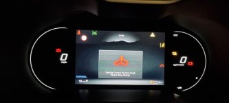

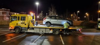

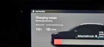

Collected my new mg zs 2022 last Friday and already had two occasions when that happened. Each time called aa and they take a car to a garage. They said further investigation is required.
Pictures of the issue
