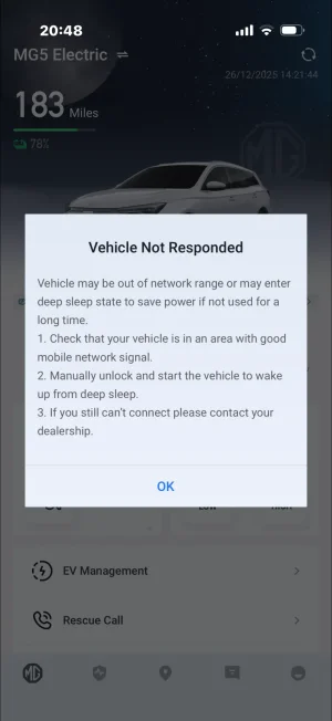

I’m having a problem with my FL MG5 and hoping someone here might have some advice. The car keeps having trouble connecting to the app, I keep getting a vehicle not responding message whenever I try to use it and only start working again only after I unlock and lock the car. I drive the car every day, so it’s not sitting unused for long periods.
Has anyone else experienced this issue or found a fix for it?

Greetings from Germany 🇩🇪 and the MG4 forum. I’m usually active there as an MG4 driver and only discovered your thread here by chance. The issue with iSmart and “Vehicle not responding” also occurs on a fully updated vehicle, even while it’s charging at a public charging station (regardless of AC or DC). I noticed this error message today at around 08:00 GMT. After updating the app again at about 09:30 GMT, the vehicle was reachable again. Sometimes I think the servers are just acting up, and at that point local network coverage no longer matters.
Have you tried force closing the app, clearing the memory cashe (not data) and try the app again.
Works for me when i have app issues.
I'll upset the apple cart, just a little. I've not encountered the issue for quite a few months now. Today late afternoon put the car on charge & immediately the app provides status etc. TBH I only use the app when charging. I turned off charging (early evening) via the app & restarted the charge a just now; again the app OK. Meanwhile, just going back to when I did encounter the issue last year, it was transient. For example I'd experience the issue then try again an hour later (whether home or supermarket charger) the app would connect just fine. I'm due a service in several weeks, but if your general theory (as a result of service update) holds & I encounter the same, I'll report back.
Our 2022 FL MG5 Trophy has done this from day 1. It randomly is not available and it is the car shutting down, even when on charge. The work around for us (MG UK are useless at sorting things like this out) is to use the lock button on the key remotely i.e. in the house, this gives the car a nudge, we can then pre heat / pre cool as required. There doesn't seem to be any pattern to it, it simply nods off whenever it feels like it. As we don't intend to keep the car I no longer pursue the matter with the dealers, save my breath!
My car was in last week for this the dealers told me they couldn't find anything wrong with car etc but told my they did some reflashing/reinstalling etc with the software i don't understand all this software stuff my car was all OK until about the time it went in for first service september 2025 noticed it more when needing to pre warm car in the colder weather.
Maybe a TBox replacement could help. I know from my MG4 that TBox updates are done separately and a lot of MG car dealers here in Germany don't know how it's done. In my case TBox updates plus SIPS updates were the solution.
I would imagine it wont be easy to get MGUK to agree the Tbox swap because in their eyes it is working and not faulty.
