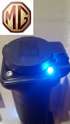

Anyone brave enough to try one of these?
Just had one of these delivered, I've just been outside and it looks too be working fine. I must also have the update as I was able to turn the car off and lock it up! The advantage of this discharging connector is the light on it shows its discharging OK. Happy so far
I have one of these and it didn't work. A friend also let me try theirs and it didn't work but they tried mine and it was fine so the adaptor wasn't broken or anything
