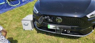

Taken the car camping, I've been running this electric cool box on full chat for the last 2 days, only taking it off at night. I've used 3% of my battery in that time! My car is lockable while discharging

Update: went to the pub came back to grab a beer from the cool box and realised that the fridge wasn't running.... the car had died!
I attached jump leads to the 12v battery and we were back in action.
The moral of the story is the 12v battery will drain if left discharging.
