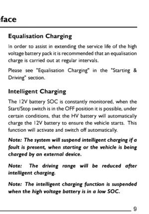

It's never as easy as it should be to find the information you need. But I should remember: "RTFM" - read the flipping manual. This should eliminate the 12 volt battery depletion problem
or is this another function promised but not delivered by MG.
I assumed you knew that the 12 volt battery gets its charge from the main HV battery which is why I said in my post #528 when I leave my car at an airport or anywhere for an extended length of time I like the HV battery to be at a reasonable level of charge as while the car is sitting there parked the HV battery tops up the 12volt LV as and when necessary this is automatically done in normal circumstances as far as I know this is the case with all BEVs.
Les
Les
Yes I knew that the 12v got its charge from the high voltage battery. My concerns were raised when, on return after a 7 day holiday, I couldn't use the app to remotely switch on the heating. The app said the car had gone into sleep mode. Cue concern.
As it turned out the car started without problem. We had 64% battery so it should not have been a problem. But I wanted to work out a solution if we'd gone away for two weeks and come back to a car in deep sleep mode. After much pressure our dealer has, reluctantly, installed some of the missing updates to our "new" 2025 plate car. And I suspect that more are needed. I now understand that one of the battery management system software releases addressed the problem of cars going in to deep sleep mode by arranging for the 12 volt to be topped up by the high voltage battery. Perhaps that is a software release that I need to press for otherwise I would want to have a battery booster or similar to prevent the problem occurring.
