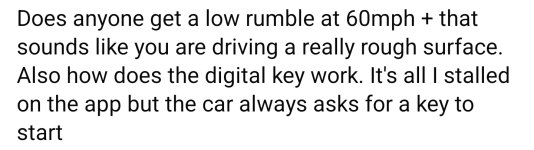

Well a strange coincidence, some Trophy owners have started to post on FB today
