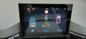

Warning Sign ⚠️
For me it's "Low rear left tyre pressure" most of the time. At around 0C the sign is gone but at -8C and below it's back.
You need to put a bit more air in the tyres, so that the normal pressure fluctuations with low temperature don't take them down below the warning threshhold.
I pumped mine up to 2.7 bar, no more warnings but slightly more tyre noise on rough road surfaces.
