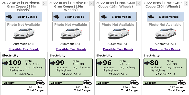

BMW official figures for the I4 quote different ranges for different wheel sizes. I'm sure other manufacturers do too.
