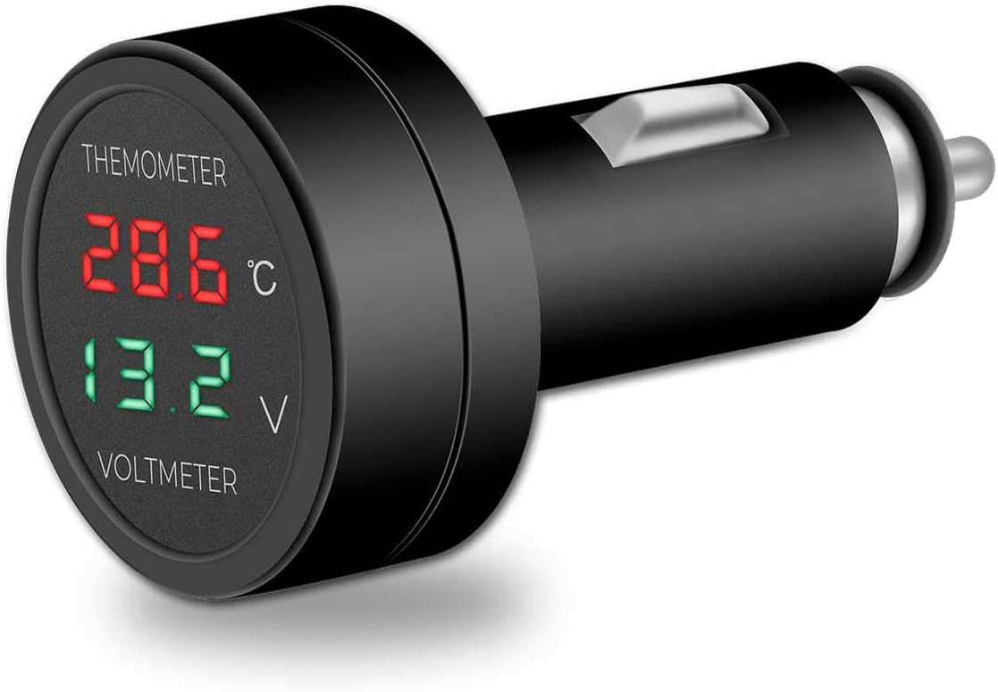

This volt meter will show what is happening to the 12 v battery. Boot light is timed out, I leave my boot open on dry days
It's good to know the boot light times out, seeing as there's no switch on it to turn it off. (y)
the 12V battery is charged in the mode of charging the main battery from the AC. A stabilized voltage of 13.1V is supplied. Also in the engine operating mode 14.2V.
