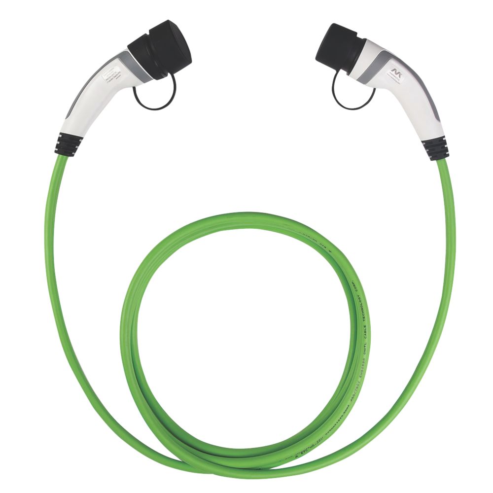

@1MGEVUSER I guess the 'Easee One' is untethered... A little late for you... but others might be interested... I quite like the 'green' lead from screwfix...
@David B Has a nice short one the same colour as his car... very nice...
Always sincere..
Marin

Very nice green but a high price to pay !
Personally I'd save £75 and buy elsewhere e.g.
Yeah - Agreed, I have the type 2 cable from evonestop and found it to be very good quality.
It does not get a lot of use as a have a tethered wall box, which I find more more convenient to be honest.
The type 2 cable get's a free ride in the boot, where it is coiled around the space saver, along with the V2L cable that I bought some time ago.
They are holding a party with the 12 volt jump pack and the 10mm spanner ?.
The 12 volt smart charger is feeling a bit "left out" home alone stuck in the garage !.
Always have a back up plan if possible, is what my OCD tell's me ;).

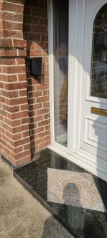

Today I had the Easee One fitted.
The electrician did a nice job and I am very pleased with the look and location position. From far away some people would think it's a post box.
Not sure if the LED strip could be dimmed at night. Maybe I'll send Easee a note for a possible firmware option that it would give dimming control in weekly programmed timing, after all, the charger can already by programmed for charge times.
Not sure the LED strip could be dimmed at nigh. Maybe I'll send Easee a note for a possible firmware option that would give dimming control weekly programmed timing, after all, the charger can already by programmed for charge times.
Really neat install to be fair !.
Under cover, tucked behind that brick pillar.
Wall boxes that can accommodate rear entry of the supply cable, always gives a cleaner / neater finished job.
I am a tethered cable man myself, but I totally 100% see why you have gone for the untethered option in your case.
I agree, you will probably find some letters wedged behind it soon !.
A new postie thinking it is a new snazzy mail box, but unable to find the flap ?.
Like the bright green high vis cable also, black could have been a trip hazard.
Good choices ?.
Good choices ?.
