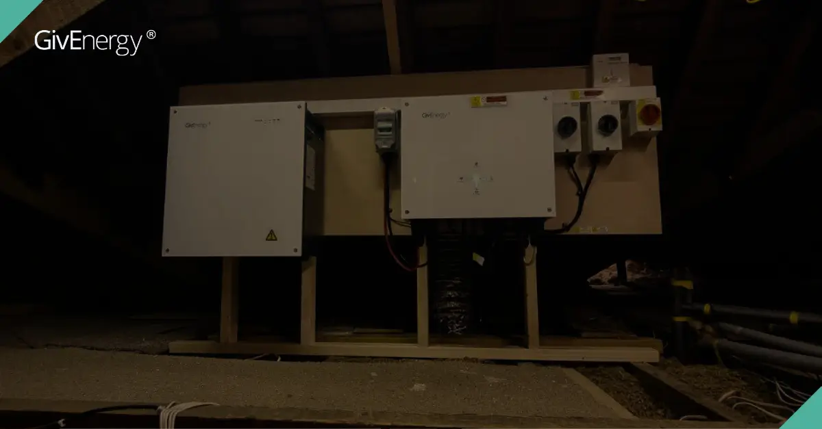

I believe that there has been a change in the recommendations, and it is no longer recommended that the battery be placed in the loft. This is not currently a regulation, but a best practice guide. It may become a standard in future
It is a proposal for consideration. Having watched the guys struggle to lift my batteries into the loft I can see very good reasoning for it, the reality is theyre better outside IMHO.
The problem with them being outdoors is the winter temps. When batteries get too cold they won't accept a charge at the same rate as when warm, same for discharge.
Same as our vehicle batteries.
Mine are in the loft (easy access) but even there they need a polystyrene box to keep them warm in winter.
The reasoning is not saving installers creaking backs. It's more about the safety of your house ?
