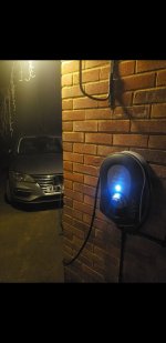

I’ve had my ZS EV for two weeks now and I had the ohmi charger fitted. It’s tethered and only the cable hangs outside. The main body is inside the garage. Very convenient and the app does it all. Recommend it.
