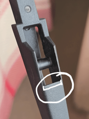

With minor modifications the Bosch H281 (11 inches) works very well. I needed to use a dremel to take about 0.5cm off the end, and made the hole in the centre section of the slightly larger (you can use the original to get the size right) so that it fits snugly in the arm and flat to the glass. Finally I used a small amount of superglue to make sure that the blade doesn't pop out (where I took a small piece off the end) but now I have a blade that reaches just under the rear light in the middle and usage/coverage is perfect.

The Bosch H281 250mm blade I bought fitted perfectly, with the very slight mod as shown and now covers the rear dashcam area without the need to alter the length, hope the superglue doesn't mind rain and frost ☔🤣🤔
I'm really sorry @Joningy, but I don't understand the mod "as shown". You show pictures of the spindle, but the part you recommend is just the blade, so, presumably, the arm remains in place.

OK, I'll try and explain a bit more @TimothyN .
Just the blade is required, but you can also buy a blade with an arm, but as the required mod is fairly straightforward, that's the route I took.
As the picture shows (thank you @MG Clive ) a small amount of the rectangular hole which the arm fits into needs lengthening by a few mm's to enable a proper fit
I used a Stanley knife.
Ask again if you need more explanation, as I'm sat on a park and ride bus trying to type this 🚍😂

I'll post it again here @TimothyN, I've already posted in 2 places here, 3rd time lucky!
I only bought the blade, but it needs a minor modification, by cutting out a few millimeters from the area marked on the photo I used a Stanley knife, not much to it, but please be careful with the sharp blade, no partial finger amputation required for this small mod.
I've used my wobbly pic, @MGclive

This is not the best fit for the rear wiper on MG4 AND MGS5, the best fit is Bosch H252 at 250mm, being just 250mm long and needs no shortening, just the minor alterations to the hole which the arm fits into.

H252 is a best fit @250mm long, H281 is too long by 30 mm and requires the end being reduced in length
If you look at the post end cutting short.
The blade I bought Bosch A252 required only a small mod to the hole/ slot where the arm goes in.
@TimothyN followed my simple mod and he's pleased with it.
