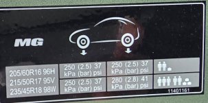

So, a question(I'm no engineer), the tyre pressure sticker looks like it states the same pressure for all models of MG4...though the X Power is heavier with the extra motor.
Why are the stated pressures the same for all models?
Also, at load it states 41psi so the tyres can be run at 41psi..., maybe the front motor is pushing down on the front axle due to weight and at 41psi the axle has now become balanced?‍♂️.
