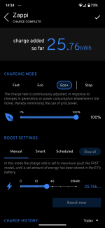

I have an MG4 and Zappi on IO all working well. I'm not sure if it helps at all, but here's my settings in the app.
nb. No schedules in Zappi are set as I deleted them before enrolling (previously was set to 0030-0430hrs on Go tariff).
I'm on the latest firmware and the only settings I have changed is a charge delay setting when plugging in, to not stop straight away otherwise my other car (Renault Zoe) goes to sleep and doesn't wake for the charge when scheduled.
IO working across both cars, but registered on the beta with the Zappi and use for both cars.

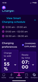

Managed to get signed up today after the initial oops something went wrong. I did raise it with them at the time and they said they were getting someone to look into it but I had heard nothing since. So looked on here this afternoon and it looked like it had been rectified whatever the problem was. So just had another go and it looks like success.
We will see what happens as I have plugged the car in and the Octopus app has set a smart charge schedule. Car currently sat at 25% so asked the app to add 55% and to be ready by 7am.
So if that works out then happy days are here lol.

Well I doesn’t look like it’s working for me. It looks like according to the myenergi app that it initially put 1.02 kw in then stopped and it’s just now saying charging delayed? Nothing more happened/happening.
Looking at the MG app the percentage hasn’t changed from when I plugged it in still at 25%?
I have looked at the Octopus app and that is still showing the schedule times and at the bottom it shows 1.02% added in the 12 hours bit. I have tried the bump charge bit and that comes up with failed to trigger the bump charge.
Went back to the myenergi app and can’t trigger a fast charge on there either so unless I can sort it out then I’ll have to be going and finding a charger somewhere

Set Zappi to fast, unplug you car and plug in again.
I unplugged the car and I have checked the delay features on the charger and reduced them to the minimum and whilst I was there I checked the firmware and noticed it wasn’t on the latest firmware so I have updated that and then I have plugged back in again and it’s started now.
Looking at the Octopus app it is now showing a charging schedule for 5.33 till 7.00am the latter being when I had set it to be ready by.
So I don’t know if it was the firmware or the delay features that caused the problem or not but I am hoping that it’s sorted now. I’ll have another go tonight as it won’t have charged up to 80% by the time it has finished at 7am.
